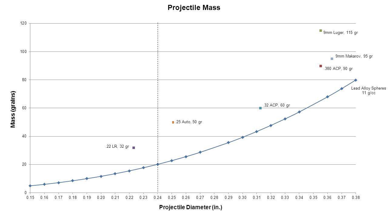

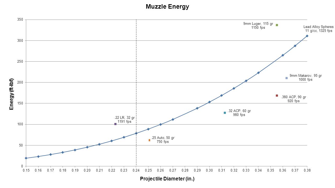

Comparing individual buckshot pellets to handgun bullets can be a good analogy, but you have to make sure you're comparing similar projectiles. Comparing 00B pellets to .357 Magnum bullets is really optimistic, since even if you're not looking at expanding or deforming bullets (which any good defensive load would be), the .357 Mag is greatly superior in energy, mass, sectional density, and so on. Not to mention that a .357/.358" bullet is much more dimensionally akin to .36" 000B (the mass of a sphere scales with the cube of the diameter, so even a .03" difference is pretty significant). A much better comparison for buckshot would be lighter FMJs from typical pocket-pistol calibers like the .380 ACP, .32 Auto, or .25 Auto. Even then, you kind of have to find the compromise between comparing similar diameters and similar masses, since you're comparing round balls to elongated bullets. And on top of that there are velocity differences to throw off kinetic and specific energy figures, with typical buckshot loads (1150 - 1350 FPS range) chucking lead a lot faster than typical pocket pistols (generally 700 - 1000 FPS).
I find comparing buckshot & handgun bullets to be more useful for understanding in a broad-strokes sense what makes buckshot work, rather than accurately predicting the performance of any specific load.
I'll attach some visual aids I came up with awhile ago that help show what I'm talking about, and also link to my shot sizes guide, which gives detailed weight & mass figures for the various sizes.
