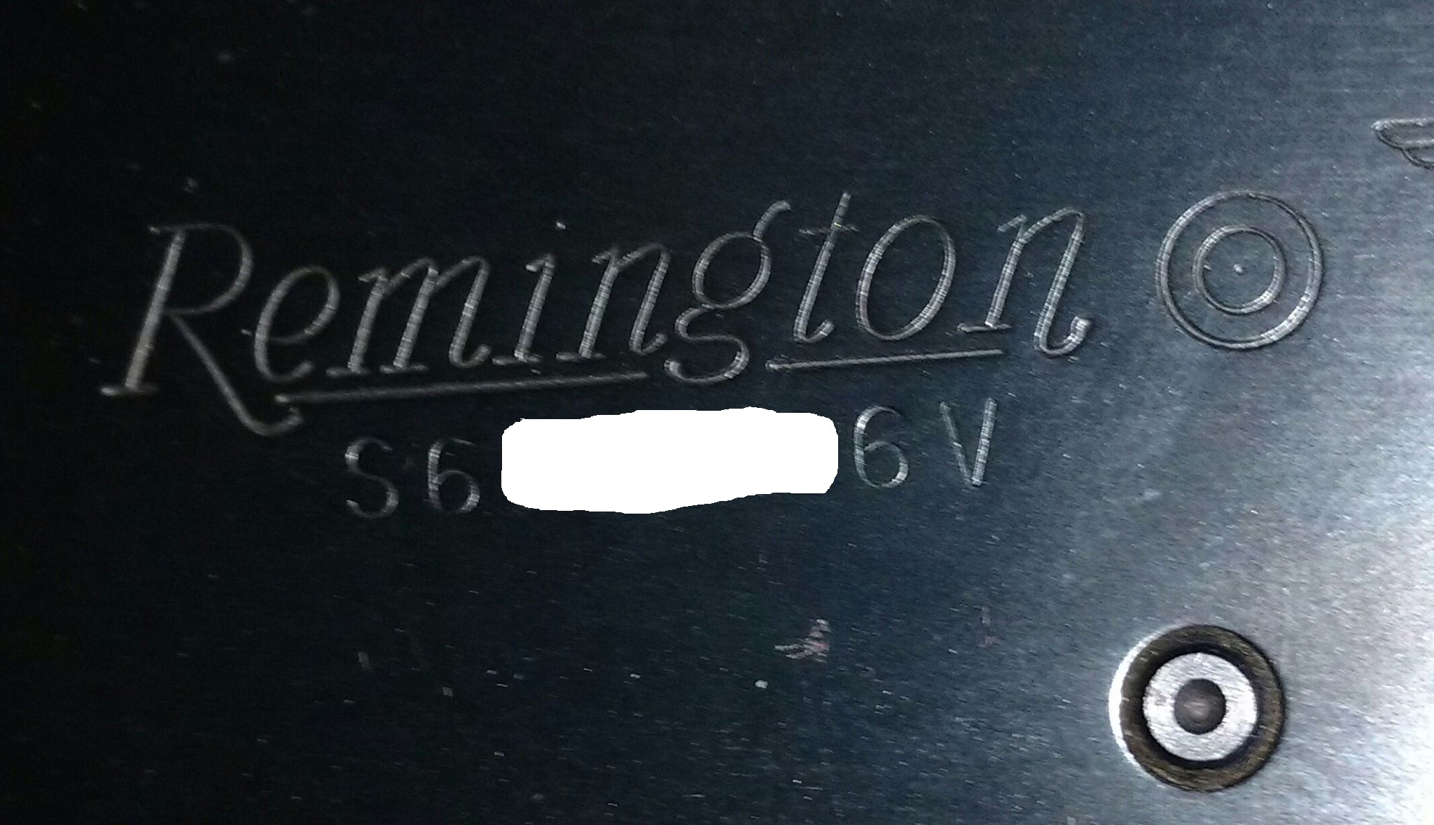

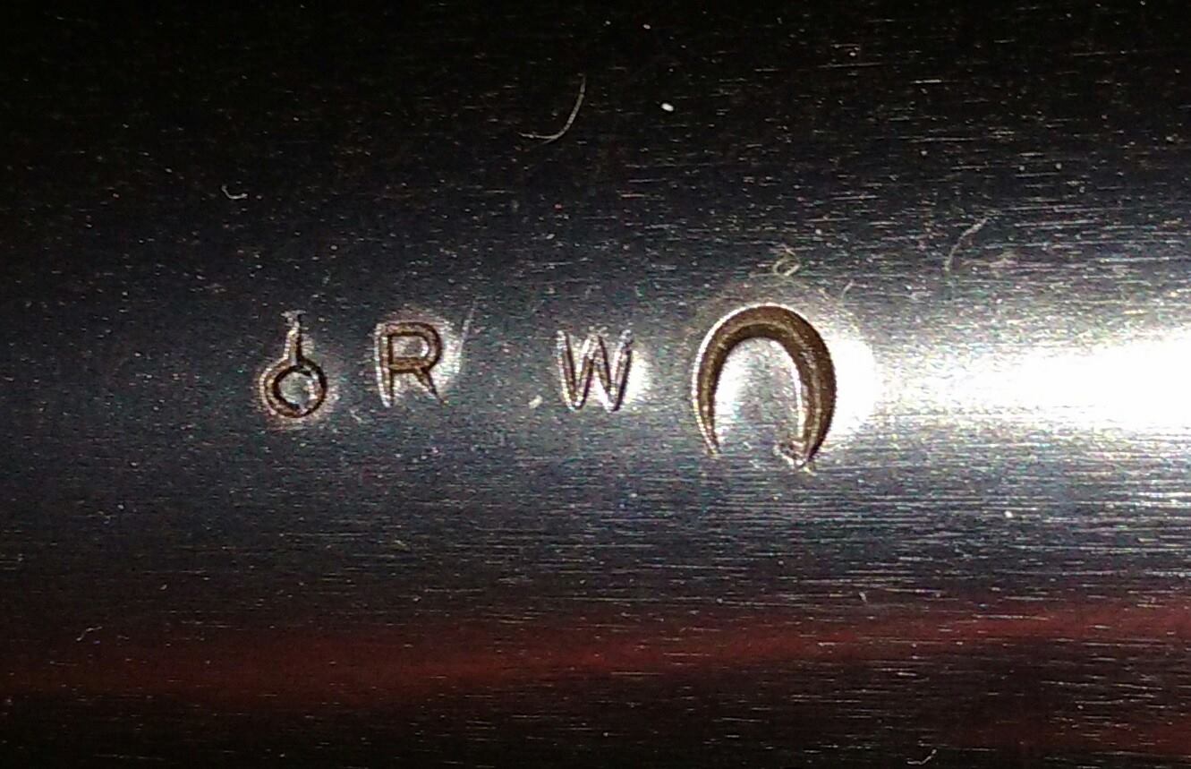

I have a Rem. model 870 12 ga Vent rib wingmaster, and am curios as to the born date. Here is the picture below , also with receiver serial num , some blocked out. Any help as to the weird horse shoe mark and the circle with the line on top would be great, thanks.

An "S" serial number prefix points to a manufacture year somewhere between 1968 and 1974. An "RW" barrel code indicates November of either 1972 or 2002. If that's the original barrel, the two seem to agree on a 1972 manufacture date.
Not sure about the other markings.
