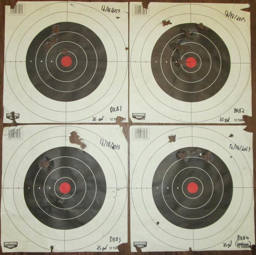

Range report. I shot four groups each of drive key slugs and round balls. Both were loaded using the same data for 1 1/8-ounces of shot at 1200 FPS (30" test barrel, so probably 50 - 80 FPS less in a short barrel). Range was 25 yards, and shots were from a bench & simple rest. The smaller holes in the drive key slug targets are from the first-timer who was shooting next to me with his friend's AK & bump-fire .300 BLK AR-15. The group on the fourth target from each set was shot using the "goober" shells that I made while working out the ideal number & arrangement of the spacer cards.
Round Balls
Round Balls
RB Targets.JPG (114.11 KiB) Viewed 16226 times
Drive Key Slugs
Drive Key Slugs
DKS Targets.JPG (104.76 KiB) Viewed 16226 times
I got them (mostly) on paper, but this isn't all that impressive for 25 yards. Easily minute-of-bear/zombie/terrorist, but I've shot groups about half that size using commercial Foster slugs and my Rem-Choke rifle-sight barrel.

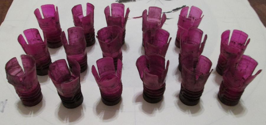

I recovered as many wads as I could. We had a fresh snowfall last night, so I found quite a few. I had the foresight to draw an "X" in the bottom of the shotcups of the wads used for round balls, so they were easy to tell apart. The wads I found were all in the same general area around the target board. The little cards I stacked up inside the wads (about 9 or 10 per shell) were spread out like confetti on the snow; some made it as far as the target board, but the bulk of them were right in front of the shooting bench, which seems to indicate the slugs & wads separated right after they exited the barrel.

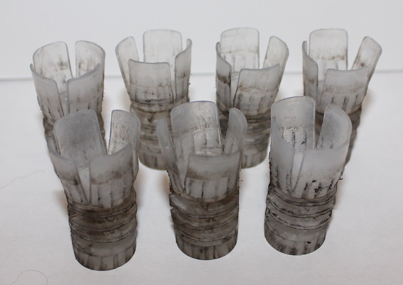

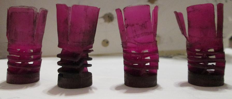

The round ball wads seemed to do pretty well. A lot of the petals had wrinkles down at the bottom, which I think was a result of the tight fit in the bore, but none of them were cut through or torn up. Overall, they seemed to be very consistent in how they were compressed & worn, which I take as a good sign.
Round Ball Wads
Round Ball Wads
RB Wads far.JPG (52.62 KiB) Viewed 16226 times
Round Ball Wads
Round Ball Wads
RB Wads close.JPG (42.63 KiB) Viewed 16226 times

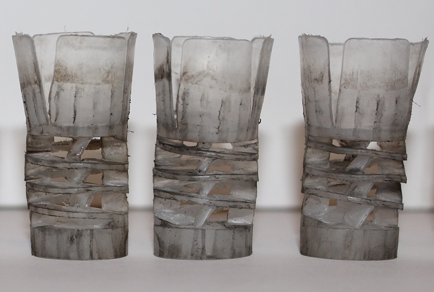

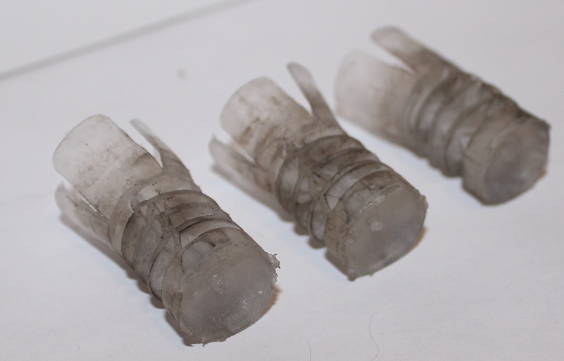

The drive key wads weren't as consistent. Some looked pretty good, others were turned inside-out, and still others had cut or torn petals. When petals were cut, the opposite petals were in very good shape, which makes me think some of the drive key slugs got tilted or off-set in the barrel.
Drive Key Slug Wads
Drive Key Slug Wads
DKS Wads far.JPG (59.51 KiB) Viewed 16226 times
Drive Key Slug Wads
Drive Key Slug Wads
DKS Wads close.JPG (33.31 KiB) Viewed 16226 times

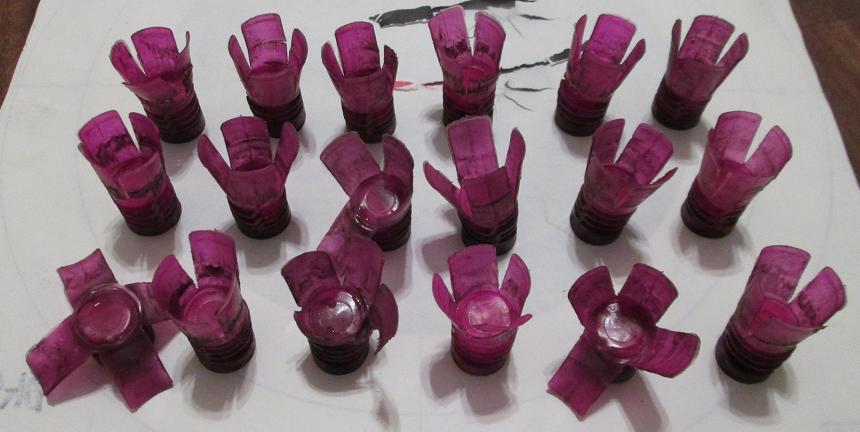

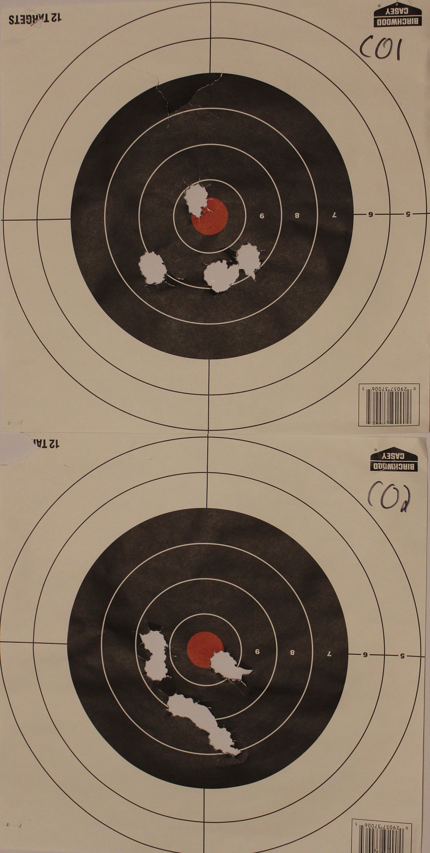

New range report. I finally found a store in the area that carries Federal 12S0 wads (I was actually on the crew that installed the upstairs office flooring in that place while it was being built last year), so I loaded up some 7/8-ounce drive key slugs last night and took them out today. The load was just a normal 24-gram (the slugs were closer to 24 grams than 7/8 ounces) target load using a 12S0 wad on a charge of 700-X in a Federal Gold Medal hull. Muzzle velocity should be around 1250-1300 FPS with the barrel I was using. I got good crimps with 7 or 8 of my 5/8" cereal box cards under each slug (some were a hair shorter than others; I think the people casting these slugs used a couple different molds), and didn't try to modify the wads.
Results were much better than with the 1 1/8-ounce drive key slugs. I think the reduced "meat" in the 7/8-ouncers helps maintain the nose-heavy mass distribution that Foster slugs need to fly straight. For the record though, I did finally find my cylinder choke tube, so these groups were shot with my 20" rifle-sight barrel instead of my bead-sight barrel. The first group I shot using the cylinder choke was with the "goobers" that I produced while figuring out the wad column for these loads, so those shells were less consistent. The two groups with the good shells (targets 02 & 03) made me very happy.
cylinder choke groups; 5 shots per target, 25 yards, target 01 shot with goobers
Cylinder Groups.JPG (364.77 KiB) Viewed 16195 times
Since I had 25 of these slugs to play with, and I was using a Rem-Choke barrel, I decided to take ten slugs and shoot a couple groups with my rifled choke tube to see if there would be any benefit. The results didn't exactly blow my skirt up. Group sizes were fine, but they weren't any better than what I got with the cylinder choke, and the slugs printed high for some reason.

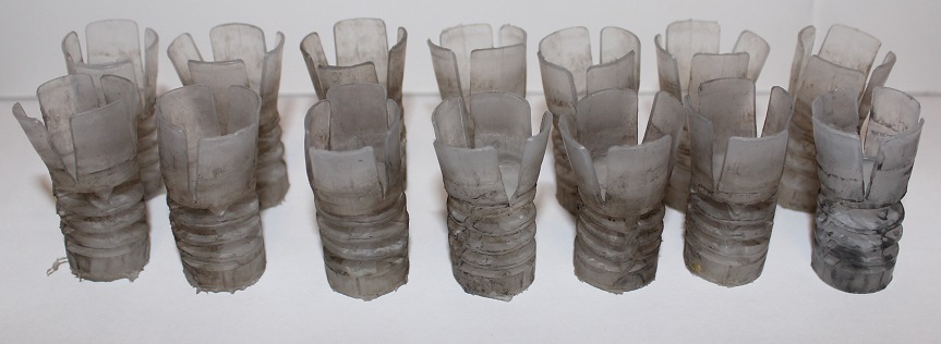

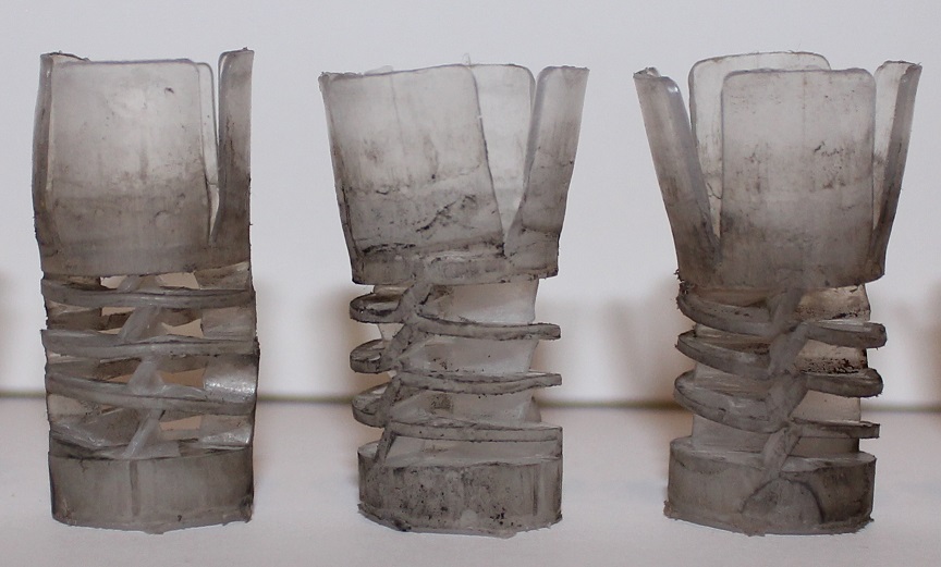

Once again, I wandered around and collected as many fired wads as I could find (luckily the range wasn't very busy). These wads looked really good. No over-compression of the leg sections, no sheared or bent petals; I feel like I could load these back into some hulls and fire them again if I wanted.
Smoothbore Wads Far.JPG (88.92 KiB) Viewed 16195 times
Smoothbore Wads Near.JPG (128.56 KiB) Viewed 16195 times
The wads that had been through the rifled choke tube had clear engraving marks on the shotcup, but the marks were pretty short & shallow. I'm not sure there was enough for the rifling to really grab on to.
Rifled Wads Far.JPG (115.8 KiB) Viewed 16195 times
Rifled Wads Close.JPG (140.84 KiB) Viewed 16195 times

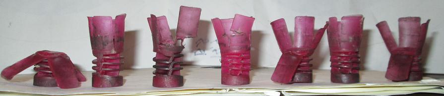

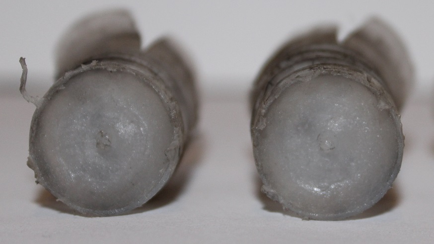

One thing that did interest me was that the rims of the over-powder cups on the wads that went through the cylinder choke tube were chewed up somewhat. The over-powder cups on the wads that went through the rifled choke tube look fine.
Smoothbore Wad Damage Far.JPG (81.77 KiB) Viewed 16195 times
Smoothbore Wad Damage Near.JPG (95.5 KiB) Viewed 16195 times
The cylinder tube I was using was one of those tacti-cool breacher chokes that Remington installs on their Express Tacticals, and I think the wads were scraping along the vent holes as they left the barrel. Not sure how much this hurt accuracy, but I am sure it didn't help. I'm keeping an eye out for a new cylinder tube that won't interfere with wads.
