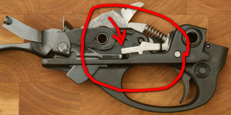

Yes, this is an old thread but I found it because I was having the same issue and found out my problem and wanted to share.
It was working fine until I took the trigger assembly out to inspect the parts. I pulled the trigger while the assembly was out of the gun and the action bar lock ended up on the wrong side of the left connector. I didn't realize it had happened. This caused my action to fail to lock. After finding this thread I was able to correct the problem and save myself a trip to the local gunsmith.
- How it's supposed to look
- Remington_870_Express_Tac_6911.jpg (220.75 KiB) Viewed 5384 times
