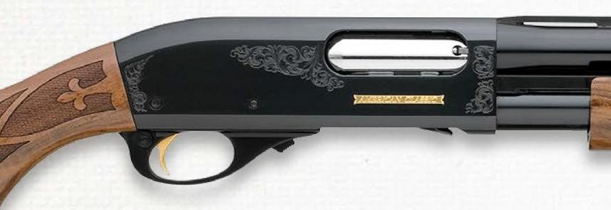

New information on the American Classic 870s from Remington's 2014 product catalog. This gun is being offered in 3 gauges: 12ga (order# 82084), 20ga (#82085), and 28ga (#82086). The barrels are Rem Choke vent-ribs with twin beads, and their lengths are 28" for the 12ga, 26" for the 20ga, and 25" for the 28ga. Stocks are standard 14" LoP, and specified weights are 7, 6.125, and 6 pounds respectively (the same as similarly-configured standard Wingmasters). MSRP for all variants is $1249.
AC870 Rec.JPG (30.36 KiB) Viewed 3419 times
I've got to say, this is looking like one classy 870 if you have the pockets for it (though to be fair, $1249 is nothing compared to some of the high-end shotguns out there). Dressed up and eye-catching, but tastefully so, not so over-done that you'll feel bad about actually shooting it. And of course, under the decoration it's just as solid and dependable as any 870 that got dragged through a Vietnam jungle or knocked around in a prison for decades.
