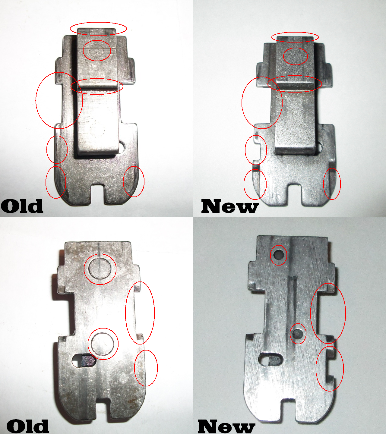

The only really major, model-wide design change to the 870 since its introduction was the flex-tab update, where the breech bolt, slide assembly, and shell carrier were modified to prevent a certain type of malfunction from locking up the action. But that happened around 1984, so a 1988 model should have the updated parts. There have been other tweaks over the years, but most were minor things that shouldn't affect performance or reliability.
The one other thing you might want to check is the choke. In 1988, interchangeable choke tubes had only been offered on new 870s for a couple years, and some 870s were still running fixed chokes. I don't know if that matters to you, but it's worth mentioning. But even if your friend's gun has a fixed choke, you could buy a Rem Choke barrel or pay a gunsmith to thread the original barrel. For $200 for the gun itself, you should be able to add interchangeable chokes and be out the same as or less than what you'd spend on a brand-new 870. And as Chief Brody said, a used 870 should already be broken in and slicked-up for you.
