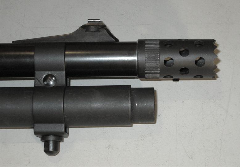

As for adding choke tubes, I'm really not clear on your description:
paully33 wrote:my shotgun just has the small bead sight on it and it has the factory installed extended chamber tube on it.
Did you mean to say it has a factory magazine extension? Or that the gun has a fixed extended magazine tube (see the image above)? Did you mean the gun came with the factory extended choke tube that looks like this?
Slide breaching choke_small.JPG (38.66 KiB) Viewed 6576 times
Without knowing what you have, it's hard to tell you what your options are. It would be a lot easier to answer your questions if you can provide an exact model, an order number, or even a few pictures.
