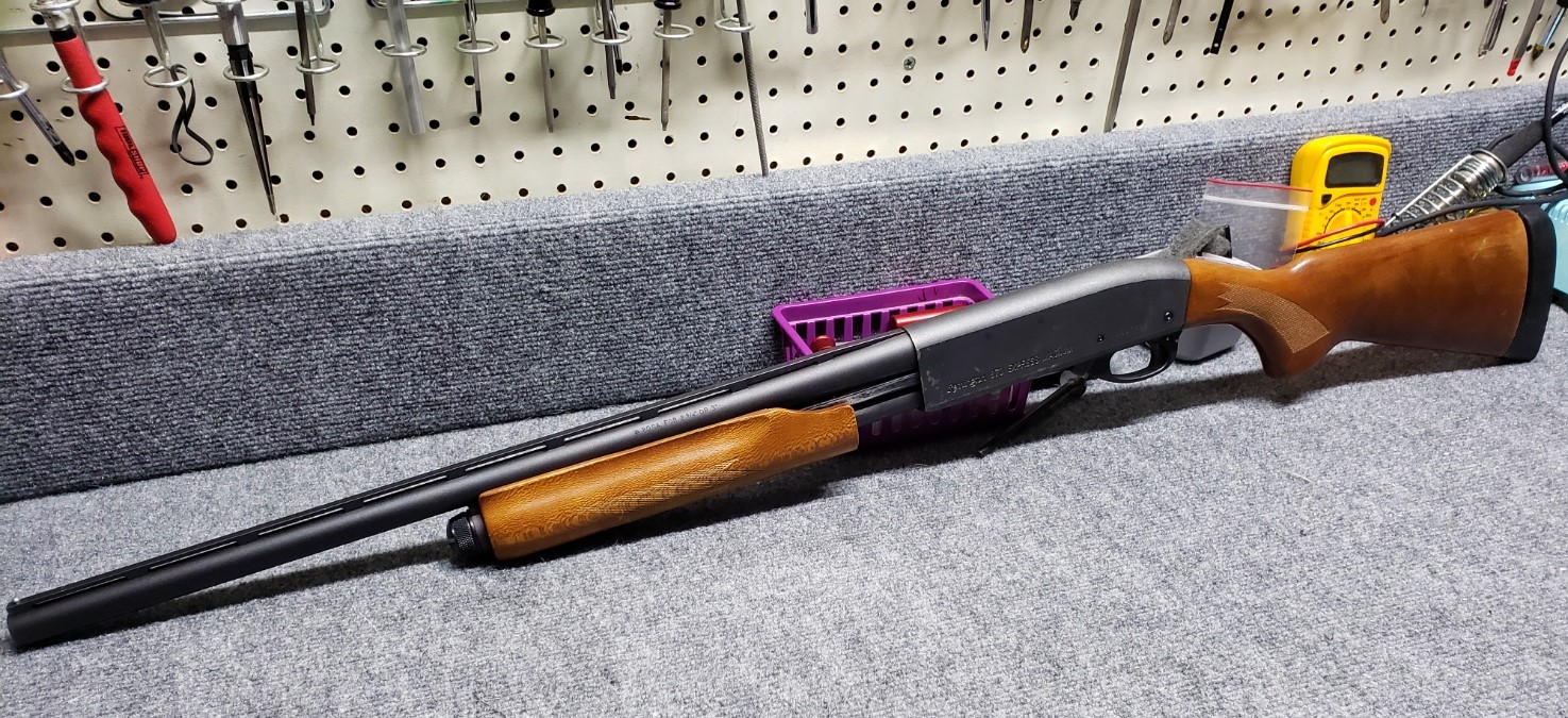

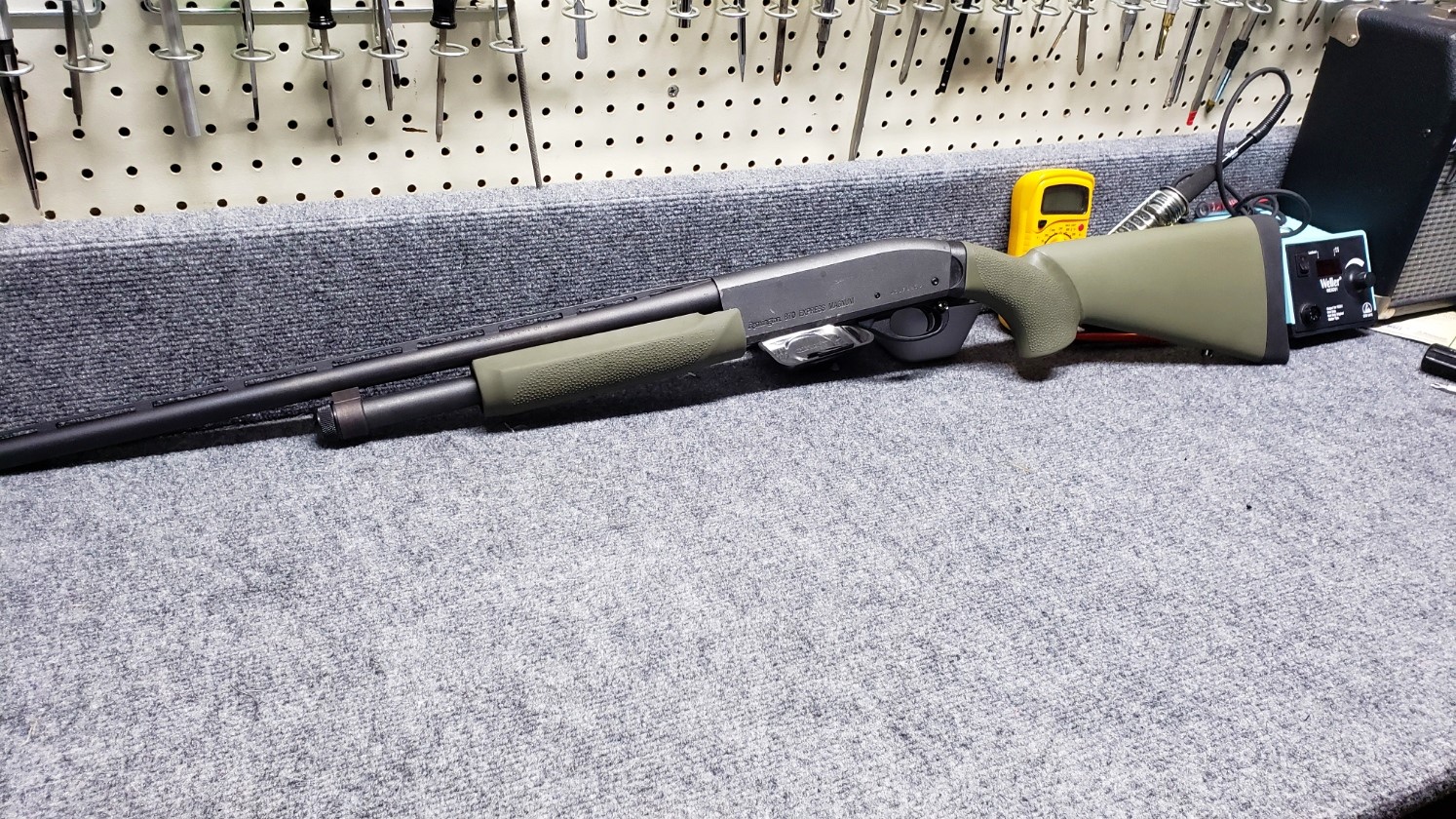

Hi All,
I started the conversion of my 870 into a home defense shotgun this weekend,
I swapped out the furniture this weekend for the Hogue setup. Really happy with the results.
I use Hogue for my handgun & Airgun grips also.
I'm having an issue with the Forend nut not tightening all the way.
It's close but can't seem to get it to fully torque down. This leaves a tiny
amount of play. The shotgun racks just fine, but want to get rid of the slop.
I'm headed to the hardware store later today to see if I can find a washer to take
up the slack. I'm wondering about an O-ring as a solution.
Curious to hear if anyone else has run into this issue?
I'll update once I find a solution.

- 870 Wood.jpg (458.56 KiB) Viewed 4802 times
- 870 ODG.jpg (580.59 KiB) Viewed 4802 times

It's NOT THE BARREL RETAINING NUT, It's the nut that holds the Forearm on.
YES, I had the same problem & also the gun would rack hard because the rubber would rub against the barrel.
Fixed it the same way you want to, a washer under the Forearm Nut.

Are you using a shotgun forend wrench, as these types of tools help you get it properly tightened and aligned. We see lots of loose and misaligned forends in the Armorer courses we teach. Loose and misaligned will cause the action bars to get bent, and can also cause feeding issues where you are not getting a single shell to release from the magazine tube or you will get multiple shells to release at the same time.
