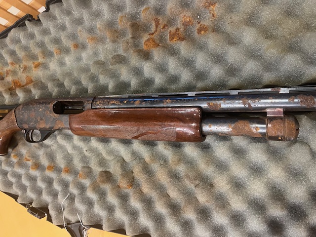

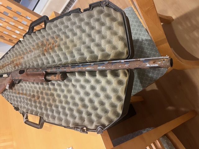

I aquired a mid 70's 870 wingmaster that needed some attention, mainly with rust. In the dissasembly process, after removing the magazine tube end cap, the spring assembly was not coming out under pressue and slightly depressed inside the tube. I spayed some WD40 inside the tube, which didn't look to bad and thought maybe if I pushed it in, cleaned, lubed, it would all slide back out. I eventually wound up pushing the spring assembly all the way in where it's stuck in that position. Realize this may have been the wrong thing to do and seeking wisdom about what to do from here.

Hey guys, I was able to find a long thin plastic painbrush handle and push the spring keeper back up to the top where I could work it out. The inside tube was free of rust and was able to clean it out. Was really stuck till you guys helped me out...Thanks! Nice to know these tools are available as well. Got her stripped down and doing some cleaning. Need to work on the rust and figure out what to do next.
