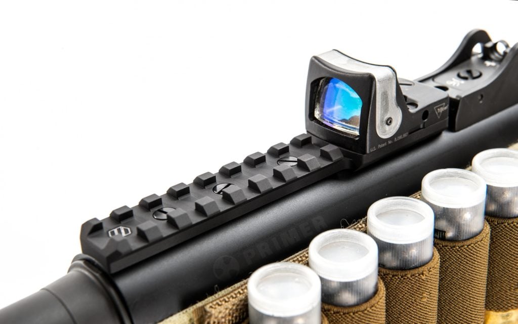

A I have a gorgeous 1100 with an LPA ghost ring sights on it. I love it! So, I'm thinking about sending barrel to Vang Comp for their barrel treatment. I notice their ghost ring sights look just like the LPA set. What is the purpose of the rail attached to the Vang Comp sight? What else could I possibly attach to that rail? I only put a rail on my 1100 for the rear sight.
My thought is to send the whole gun in, do the barrel, Vang sights, and ceracoat the whole gun. OR drill/tap, add my own rail, mount up the sights and ceracoat myself.
I just don't get the stubby little rail. :-) Thoughts?
It DOES occur to me that the sight is removable, then you get the rail to add a red-dot or something??

There's a wide variety of rail mounted sights that you can put on it. Probably wouldn't need to remove the rear aperture either. You could stick a red dot on there and leave the sights alone as a backup. Modern red dots are coming in smaller packages these days, you really don't need that much real-estate on your gun.

Fair enough! Ancient post and I thank you for your response. I've since learned a few things! So the Vang sight and rail are one piece. You can't take the sight off and slap on an optic. I think that's a bad design.
What I ended up doing was A) left my railed, LPA 1100 alone. Porting an auto-feeder is a bad idea and would probably never cycle again. I did get an 870P and sent that to Vang for the whole works. However, I had them add a side rail and solder the LPA front sight on. They did the port job, forcing cone and back boring. The shotty is amazing!
