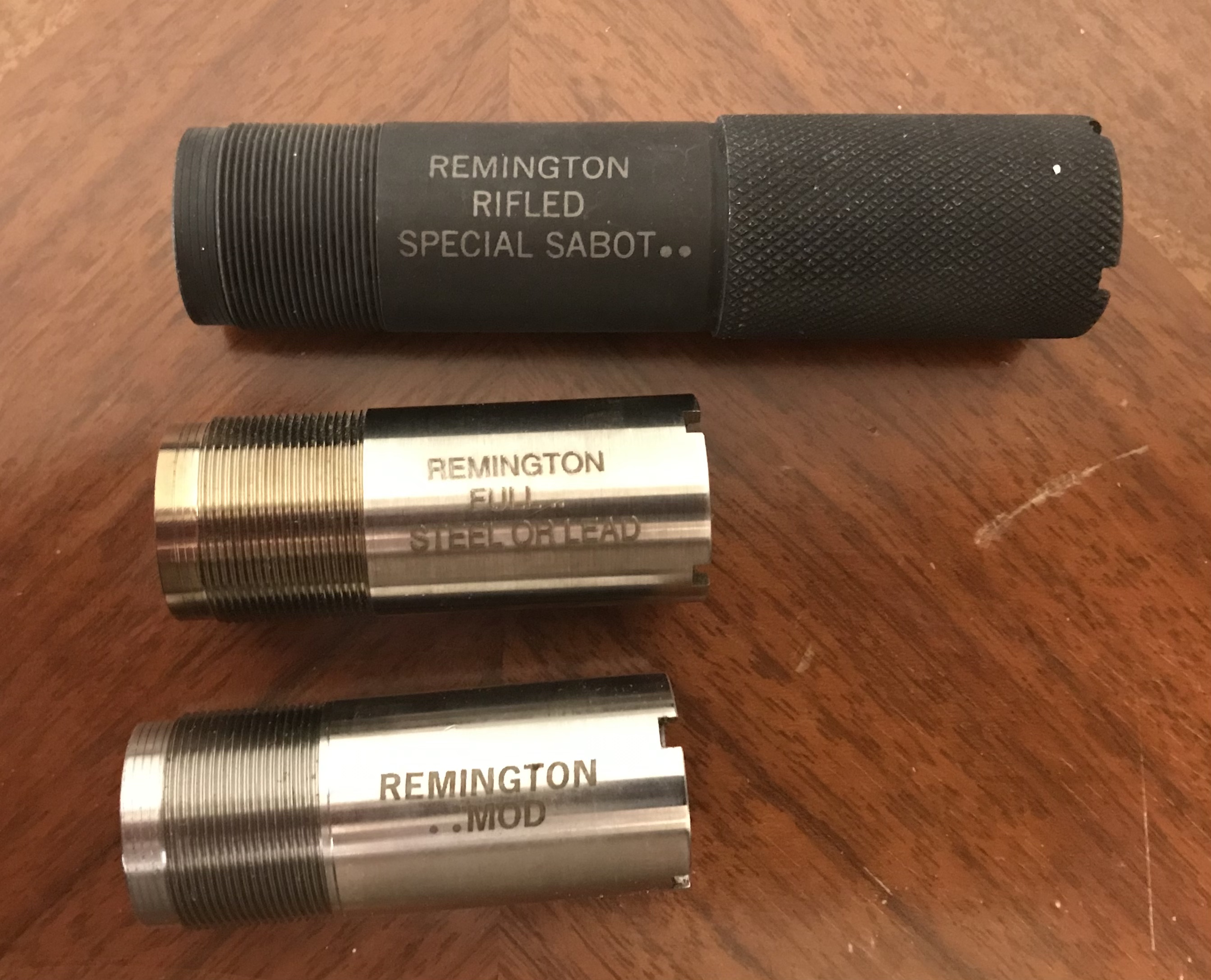

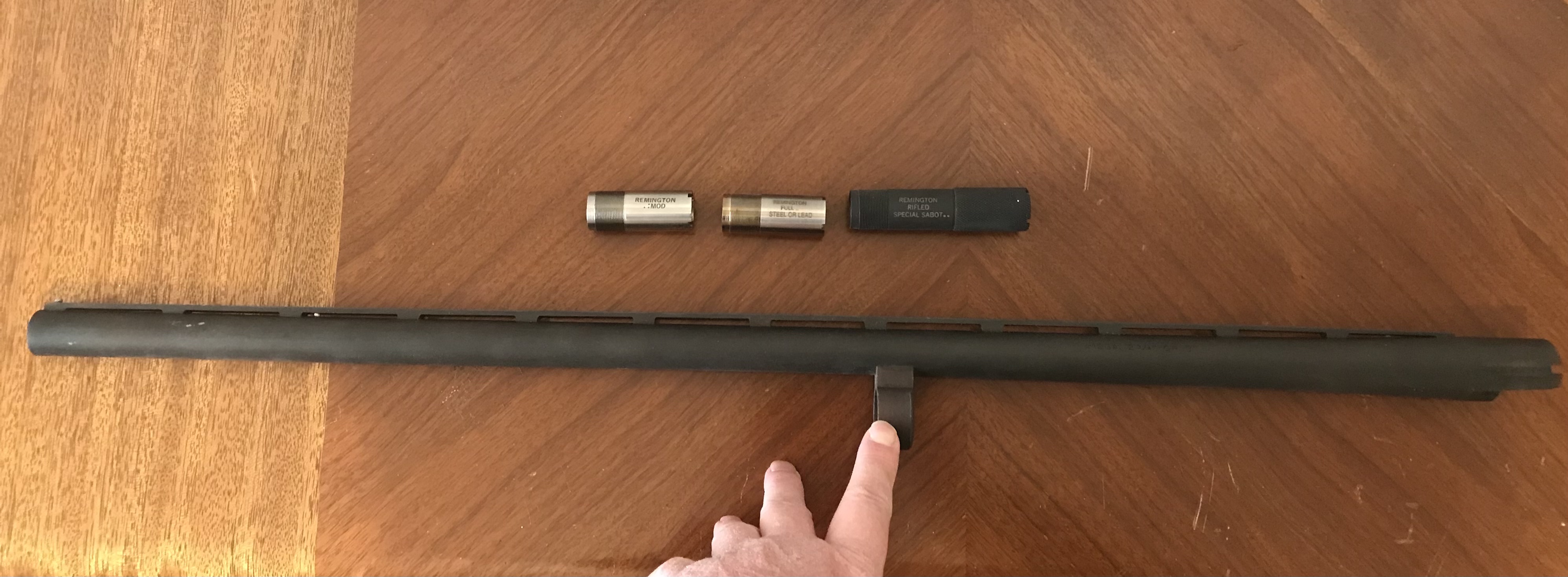

Got a used 28” barrel with chokes so I can trap shoot with less embarrassment.
Came with a Mod choke, Full choke and a Rifled Sabot choke.
What I don’t have is a choke wrench. .... so ... Questions !
