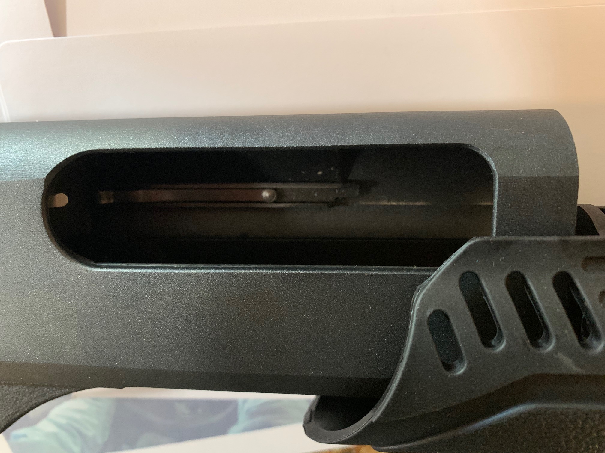

Attached is a trail fit of the ATI forend. I can cycle it without interference.
At the end of the stroke, there is a bit of coverage of the ejection port. I assume the shell will be already out by then???
If not I guess I could remove the last 2 slots. Only down side, the Strike Force does no have a bottom rail ( Not sure I would use anyway)

Those long shells pop out later than guns made for shorter shells because ejector spring bump is further rearward. You'll have to try ejecting fired hulls to know if it will interfere.
