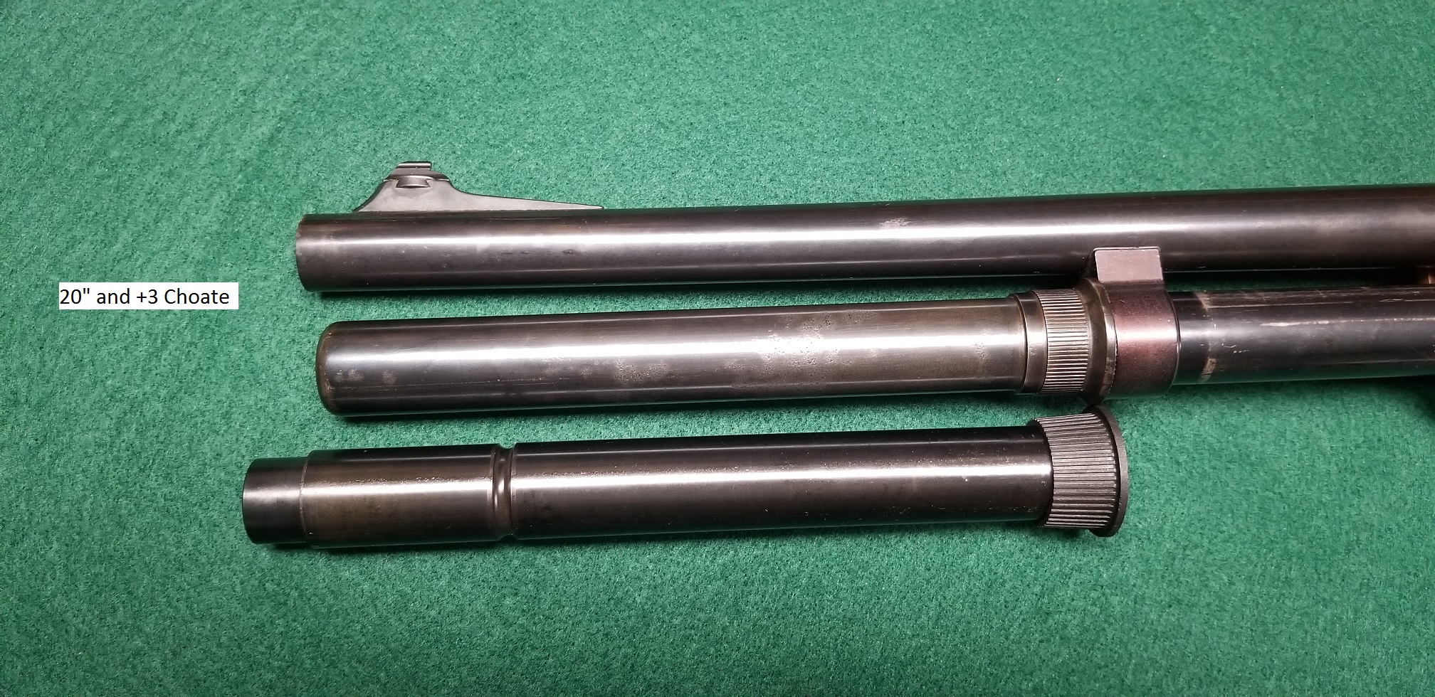

Also have a +3 blued Choate, 1-piece design, which came with that 20" bbl
11 20-in and +3 choate blue.jpg (945.96 KiB) Viewed 7051 times

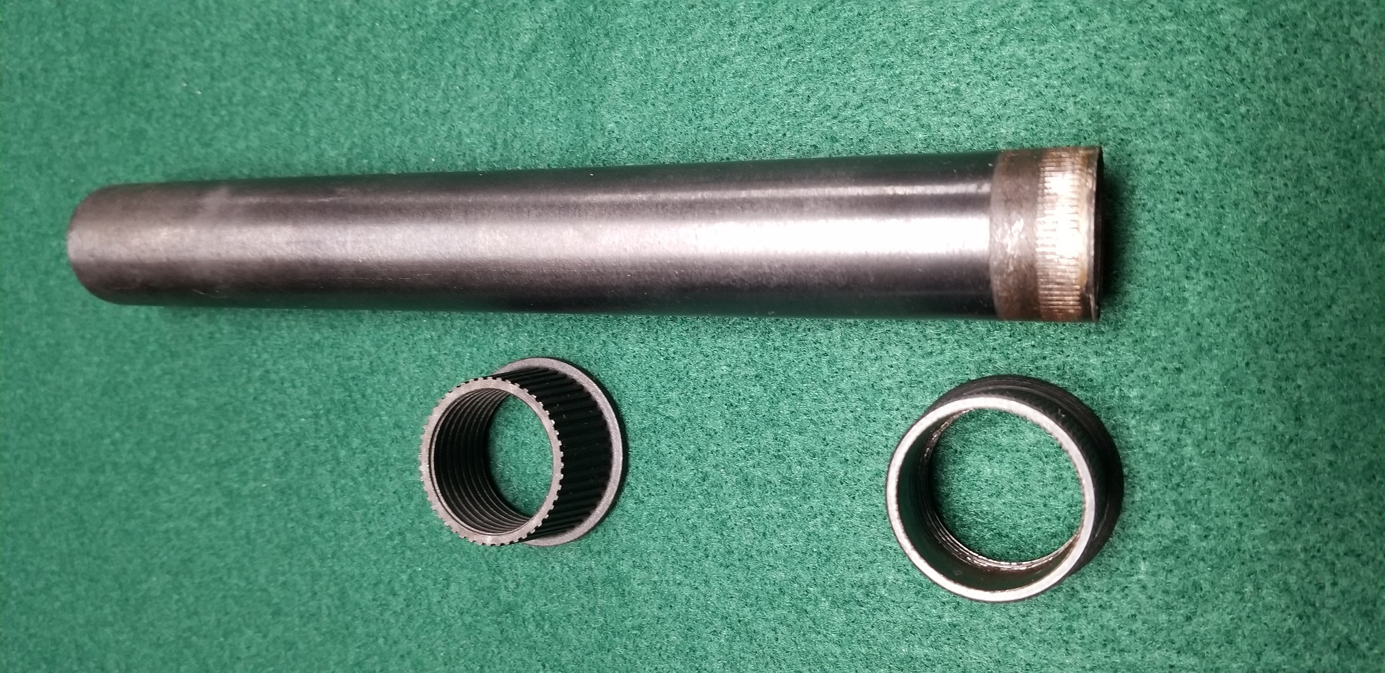

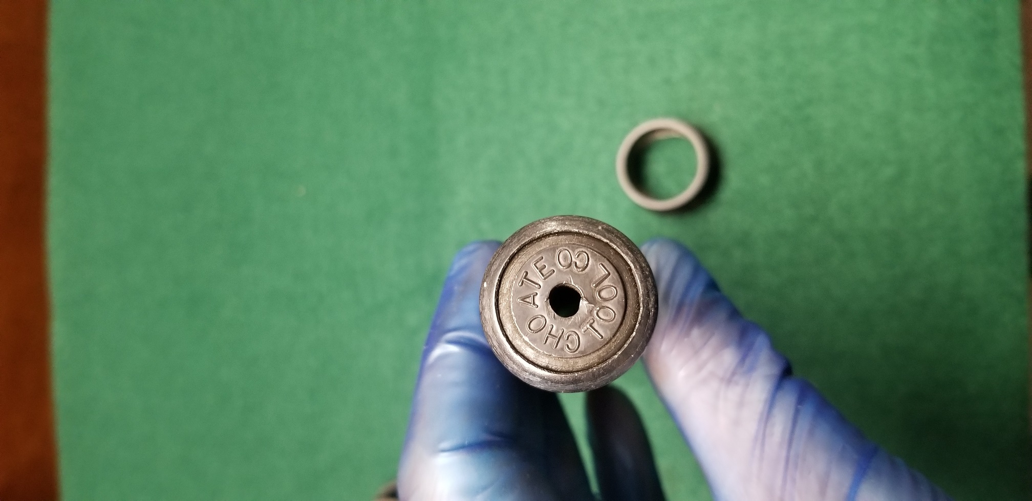

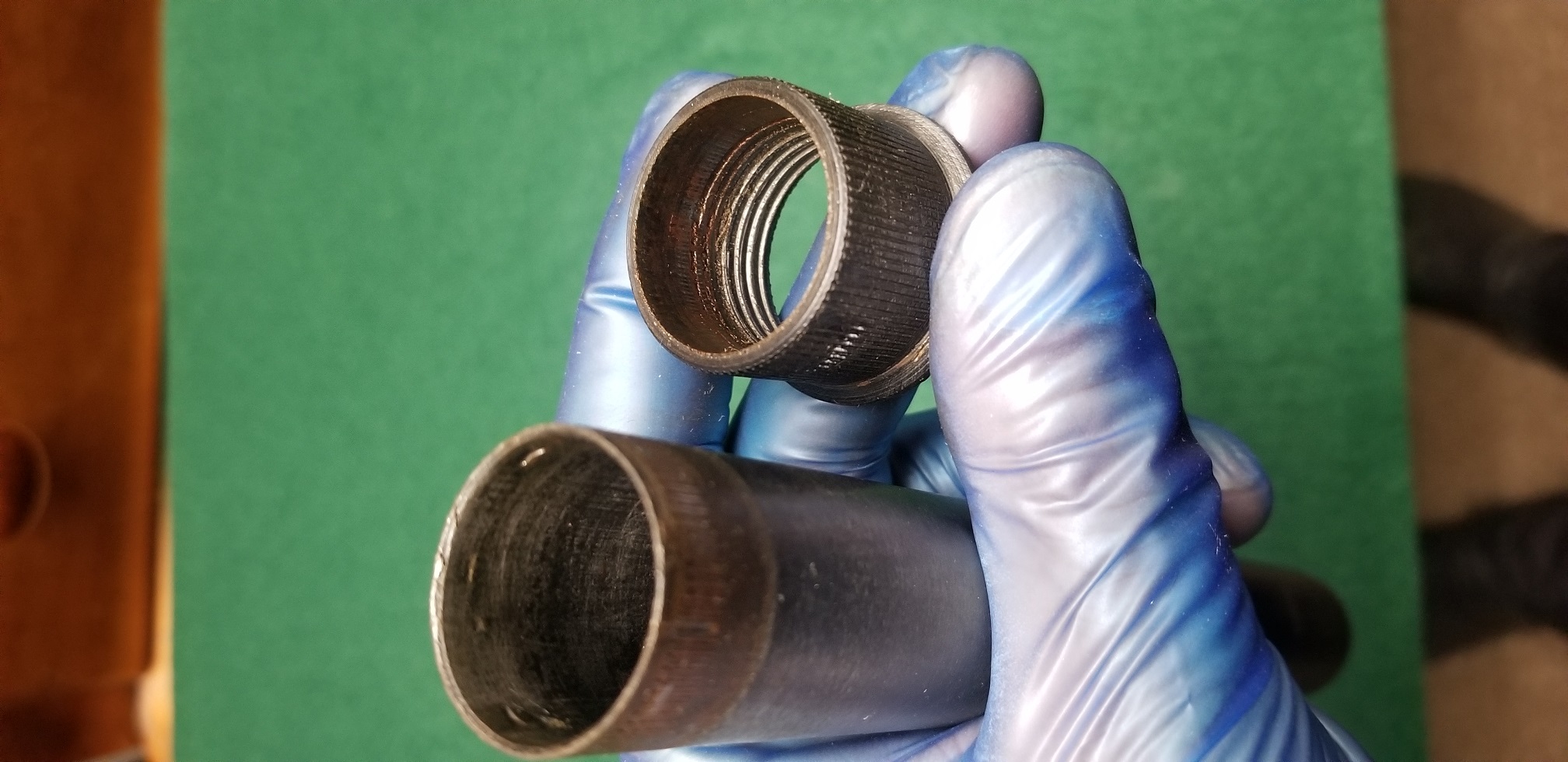

However, another +3 Choate-made has failed me a few weeks ago (no danger, just simply fell apart, launching the spring a few feet away)
choate fail detail 1.jpg (470.47 KiB) Viewed 7051 times
choate fail detail 2.jpg (850.02 KiB) Viewed 7051 times
12 choate detail - end.jpg (447.62 KiB) Viewed 7051 times

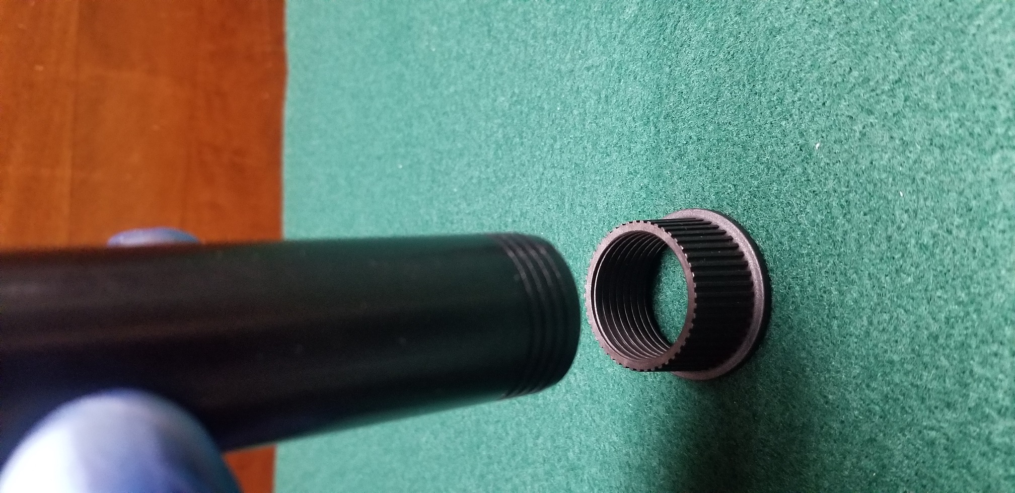

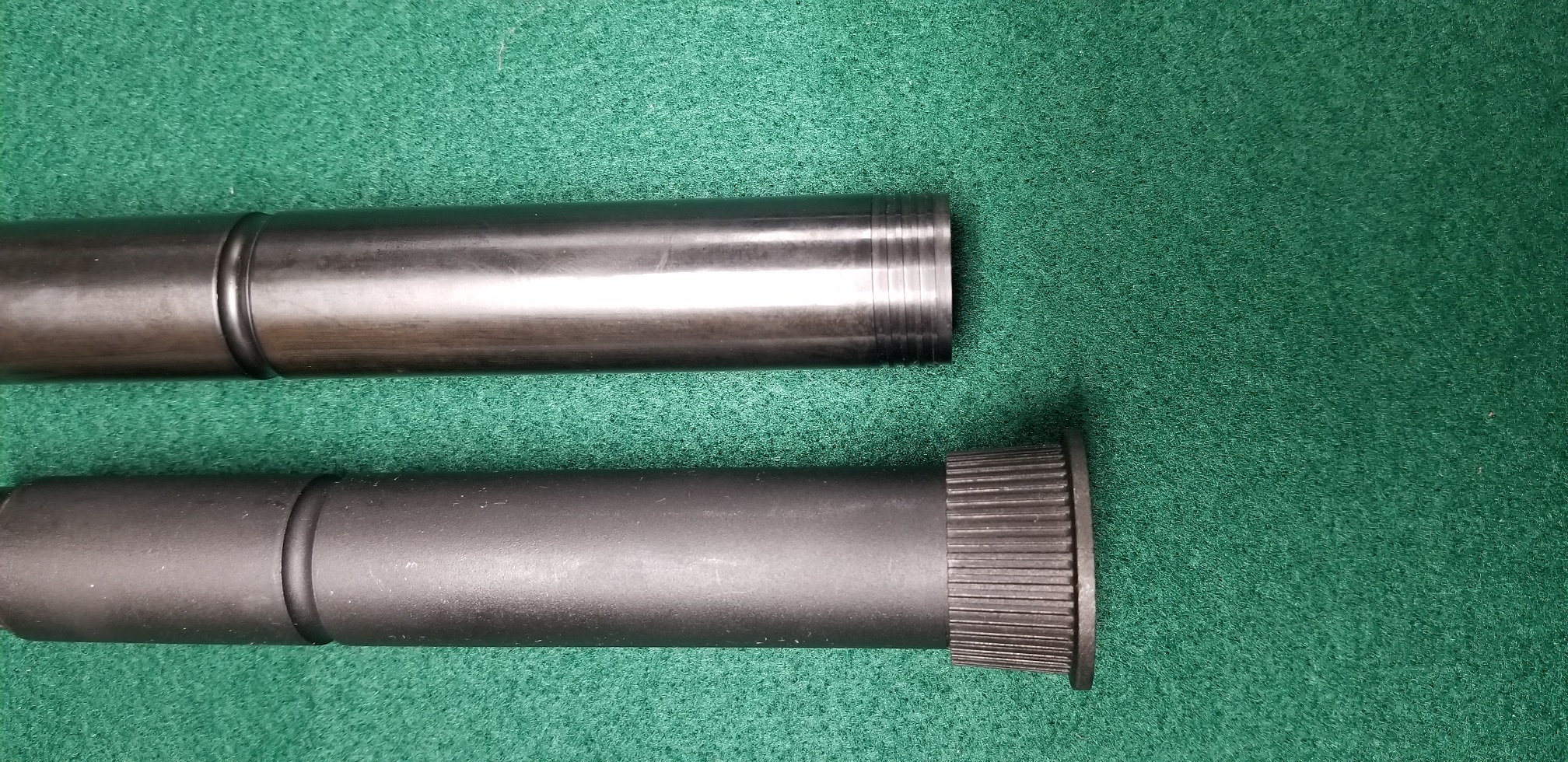

Some close-ups of Remington coupler
rem coupling.jpg (724.44 KiB) Viewed 7051 times
rem coupling finish match.jpg (1.04 MiB) Viewed 7051 times

I really liked that +3 Choate which came with my 20", until a newer one (see pix above) failed apart. After closer look, the older one seems to be soldered to the coupler, as opposed to the failed one which was just pressed in / staked (feels like). And, there is no way to check the gap between mag tube and extension. Remington's setup will ensure no gap.
