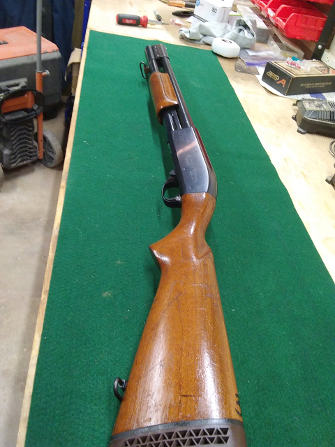

Mine turned out to be a pretty nice one. One or two scratches in the receiver, a few tiny dings on the bayonet lug. Zero wear inside the receiver.
Broke it down, cleaned it up, oiled the chips in the stock then applied a coat of Johnson's Paste Wax.
