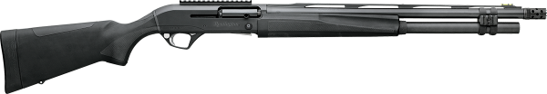

If I need a shotgun for fing Grizzley's I would carry one of these 7+1 3 inch slugs, reliable, soft shooting semi automatic

efriedrich wrote: Tue Apr 10, 2018 7:01 am If I need a shotgun for fing Grizzley's I would carry one of these 7+1 3 inch slugs, reliable, soft shooting semi automatic
Standard for the company that I work for is the Rem 870.
Re: 81198 versus 25077: Choosing an 870 for grizzly (brown) bear deterrence
The Versa Max is a nice shotgun, but that model has a 22" barrel plus the dumb extended choke, the unneeded top rail, limited stock options, and an MSRP edging up toward $1500. It wouldn't be my first recommendation for this application.
