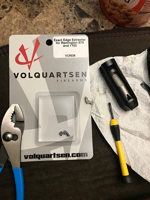

I just did the extractor upgrade and it was quite simple, cant wait to try it. The wimpy mim extractor on the right already looks worn after only a few hundred rounds. The picture does not really do justice to the new extractor, its seems like a much beefier part.
