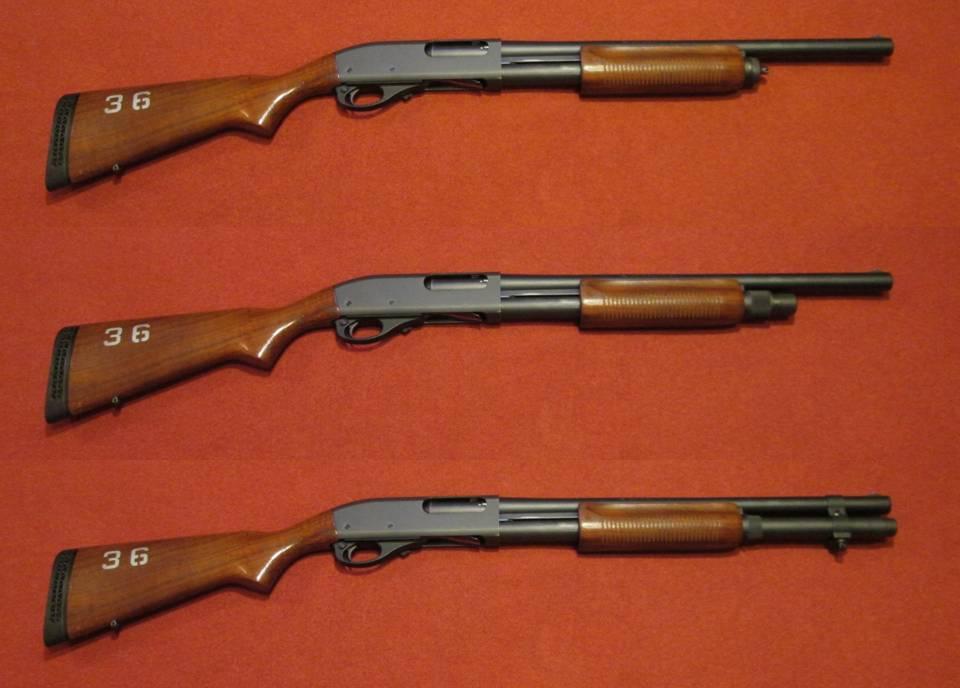

Re: Outfitting a Remington 870 Express for home defense

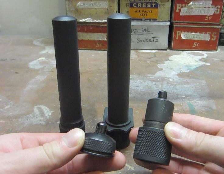

I'll echo the others; a plain-Jane 870 with an 18/18.5" fixed-choke barrel, a semi-grip stock, and a non-extended magazine is a very durable, reliable, and effective defensive tool with very little to go wrong. It's extremely quick and maneuverable due to the stock's versatile grip angle & lack of major protrusions, and the minimized weight up front. It's also an excellent base for you to practice with and get your fundamentals down before you start tacking on a bunch of accessories or changing other things that you may not really need.
The same setup with a +1 magazine extension is also very nice; single-piece +1s are very simple & robust, and are much less likely to experience malfunctions that can sometimes occur with other extended magazines. The short length also makes damage to the extension or magazine tube less likely in the event of rough handling, and has a much less pronounced impact on the gun's weight and balance than longer kits.
Extended magazines can be nice to have if you're anticipating real combat, but if you're simply looking for a practical and effective way to defend your home just in case, odds are 4+1 or 5+1 buckshot shells is plenty to send any random lowlifes looking for something worth drug money away with empty hands and full pants.
A cap and a +1 extension in front of two +2s
extensions cap comparison.JPG (48.03 KiB) Viewed 8132 times
