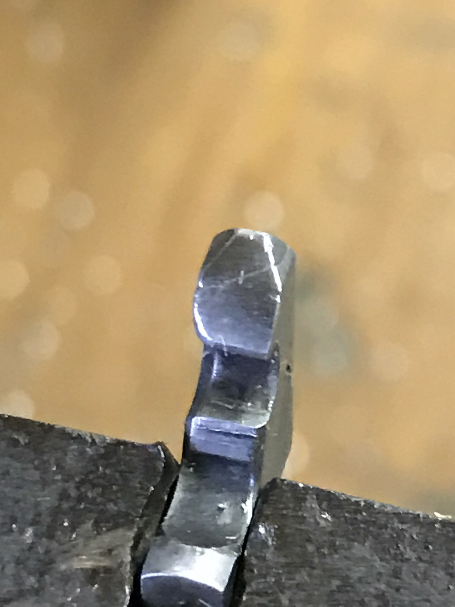

So I was cleaning my 870 magnum turkey gun a few weeks ago in preparation to pattern it for turkey season. I noticed a crack in the tip of the extractor. Luckily had previously bought a old style steel spare. So i replaced it.

Synchronizor wrote:Interesting; first time I've seen that happen. Does the crack go all the way through?
The material properties of MIM parts are virtually identical to wrought alloys when designed and manufactured properly, but they are - in theory - susceptible to internal defects if there quality issues like bubbles in the feedstock. Remington really knows what they're doing with MIM parts, but no process is perfect.
You know Synchronizer, I'm not 100% sure its a crack. Depending on the way the light and angle is, it sure looks like a crack. My eyes aren't that good anymore. I can feel it with my fingernail. I tried to see if I could pull it apart to make it gap open further but it doesn't separate any. At the time I found it, I had a spare extractor and just replaced it. On the low side the mark extends around to the bottom side of the extractor a bit. It may be a scratch. Maybe from contacting the sharp leading edge of the extractor slot in the barrel? If it's a scratch something pretty hard would have to do it. This gun has mostly seen premium brass based shells but I have shot a few boxes of the steel based shells through it.
Re: MIM extractor crack
Hmm, maybe it just got handled roughly during manufacturing or installation. I would suggest sticking with the replacement extractor just to be on the safe side, but I would be interested in figuring out exactly what's going on with it. Remington's MIM parts are generally very good; I've never even seen a picture of a broken MIM extractor before.
Is there any way you can upload some close-up images?

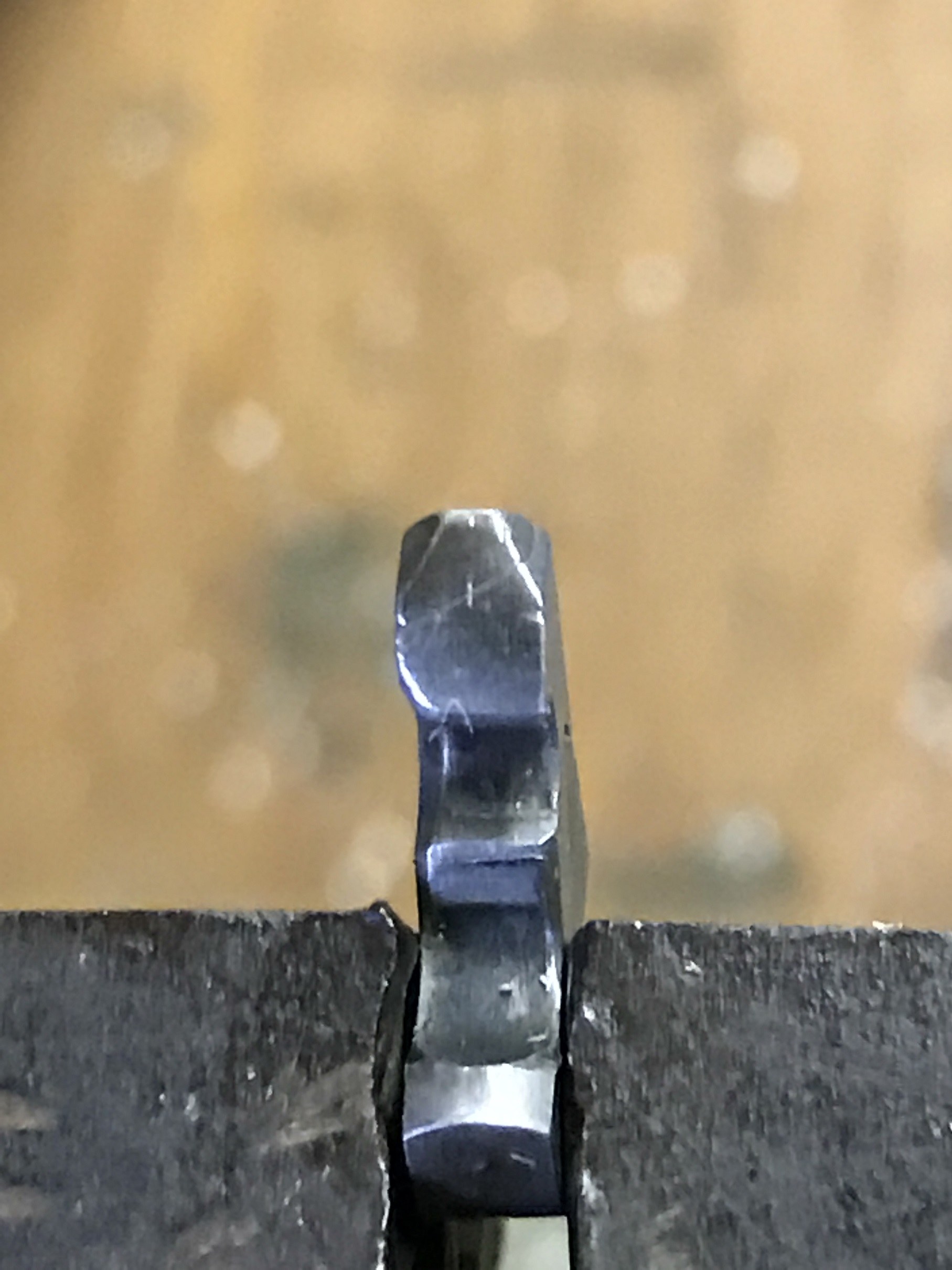

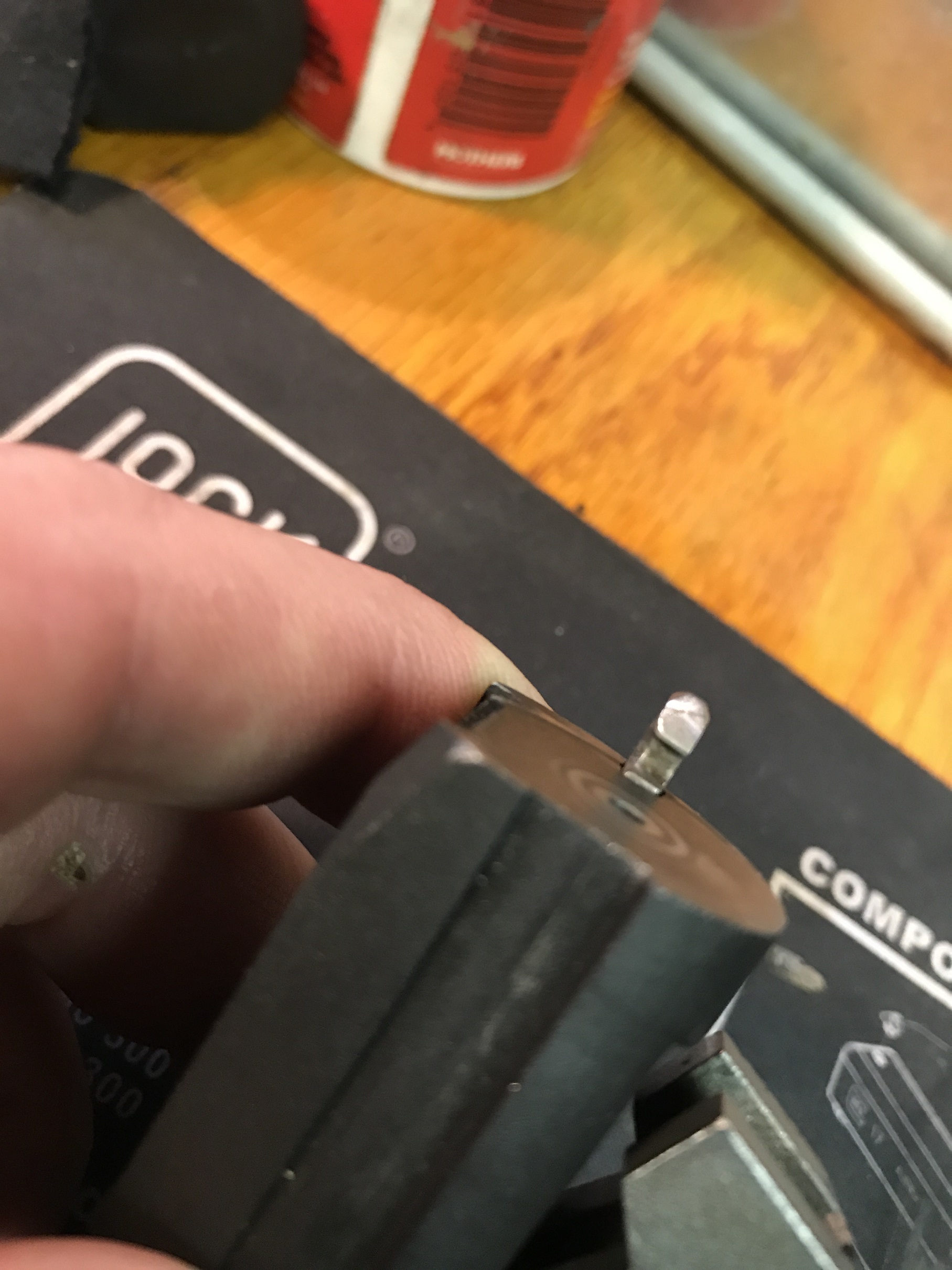

Vitaly wrote:I've heard about problems with MIM-extractor but have never seen photos of such problems. It would be very interesting to see more detailed photos.
Synchronizor wrote:Hmm, maybe it just got handled roughly during manufacturing or installation. I would suggest sticking with the replacement extractor just to be on the safe side, but I would be interested in figuring out exactly what's going on with it. Remington's MIM parts are generally very good; I've never even seen a picture of a broken MIM extractor before.
I cleaned it up a bit by lightly polishing it. These photos are about the best I can do. I put it in a vise and used my Iphone. It looks like the mark extends around the top side of the tip. I hadn't noticed that before. As far as I know, this is the original extractor from a 1995 manufactured 870 magnum (Special Purpose).

CarolinaKat wrote: Sat Mar 11, 2017 4:12 pm I cleaned it up a bit by lightly polishing it. These photos are about the best I can do. I put it in a vise and used my Iphone. It looks like the mark extends around the top side of the tip. I hadn't noticed that before. As far as I know, this is the original extractor from a 1995 manufactured 870 magnum (Special Purpose).
That doesn't look like a crack from wear or damage to me, it looks like a manufacturing defect. Like perhaps the part was dropped or banged into something when it was still green.
