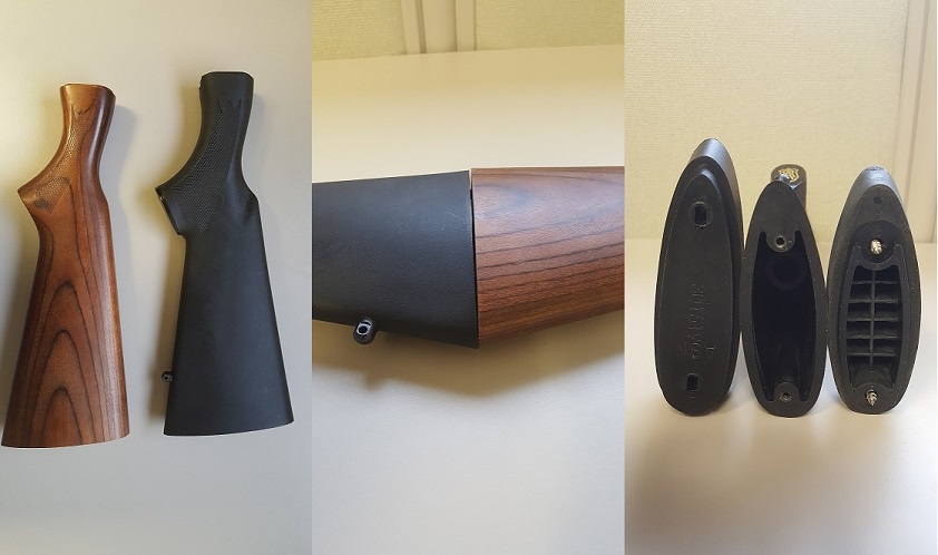

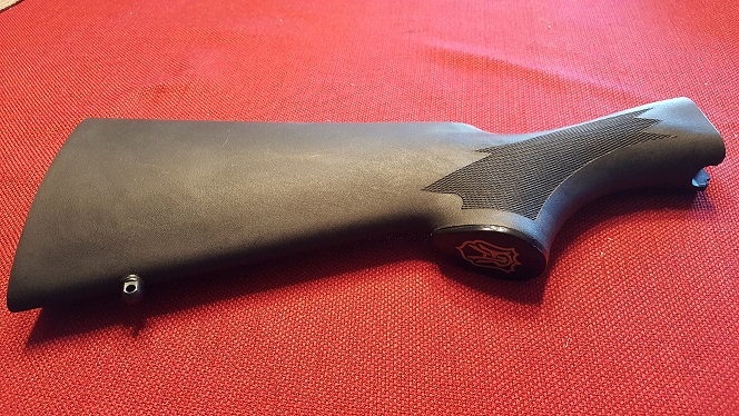

Here are a few more photos that I should have taken for my original post. Two of them show my synthetic stock next to my crappy laminate stock. You can see that they are the same size. The third one shows the butt end of my synthetic stock. The pad on the right is the one that came with it. The one on the left is the supercell pad for synthetic stocks that doesn't fit. Obviously they are quite different. Any ideas what my stock is and if there is a supercell made to fit it? I may just end up buying a new synthetic stock that includes the pad, but I really like the way this one looks with the gold logo on the grip cap.
EDITED: I realized that the images were really large ... sorry about that.
Thanks again for all the help.

In case anyone is interested, I received a reply from Remington. Evidently my stock was manufactured before 2003, and there is no supercell pad which will fit it.
