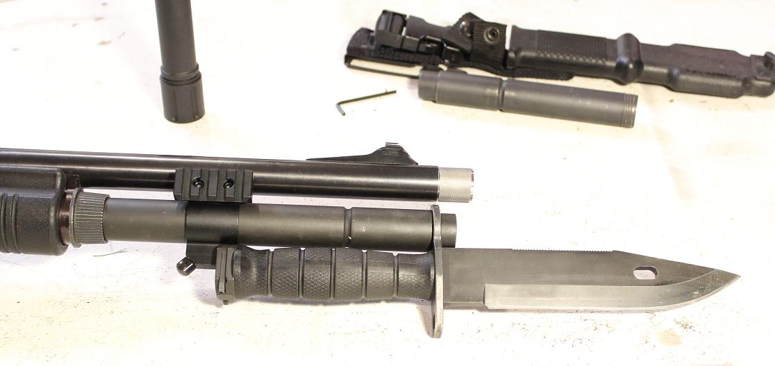

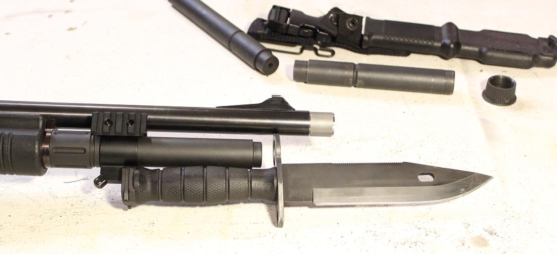

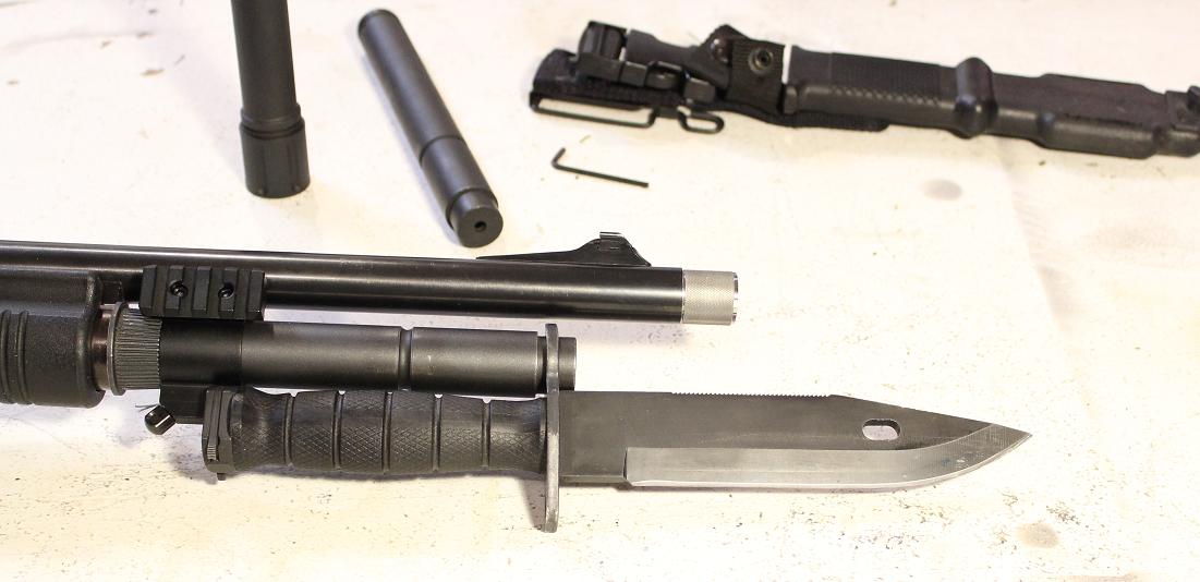

Alright, here are some pictures of my M9 bayonet mounted to various mag extensions with the NcStar mount:
With the Remington +2, the knife can't get all the way onto the extension's end cap. It's not going to be falling off or anything, but it does rattle around quite a bit, and if you're actually going around stabbing things, the aluminum rear lug is going to be taking all the force.
Remington +2
Remington +2
The Remington +3 has enough space for the bayonet to get all the way on.
Remington +3
Remington +3
With the S&J Hardware +2, the knife can't even reach the end of the extension. I suspect the S&J +3 would be long enough, but I don't have one to confirm.
S&J Hardware +2
S&J Hardware +2
