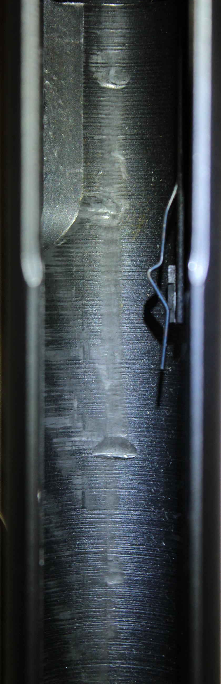

If your extractor is slipping off the shell, I would try a new extractor. if the shell is stuck in the cylinder, many polish the cylinder and that fixes the problem. One thing I never hear anyone talk about is the condition of the receiver on the inside top, Where the bolt slides along the ceiling "inside top". Mine was rough, machine marks, couple of dents in there too. I got my 870 used, but it was like new, put on a new barrel with a polished cylinder, and it was still sticking every so many rounds. Took some 400 and 600 grit sandpaper rolled up and flatten down and polished this ceiling inside the receiver, rub some oil on it and so far, all rounds eject easy and don't hang up on me. With the bolt having a 45degree angled corner on the back pull and the inside of the receiver having uneven machining and ledges to catch on, this seemed like a problem. something to look at for those with the rough express model, like mine.

Machining marks on the "ceiling" of the receiver are normal. So are dents in a couple places, which develop from the bolt's locking block camming up and tapping the metal when the bolt stops moving backward. These shouldn't cause any problems; the breech bolt is chamfered at the back, and the locking block is bull-nosed at the front, so the assembly can move back and forward over any roughness without hanging up. Plus, anything that really causes friction will eventually be worn down as the gun is cycled. It can't contribute to stuck shells, because the shell rim doesn't even reach that part of the receiver until it's partially extracted.
My 870's seen a ton of cycles, and here's what it looks like. No movement or cycling problems to report.
870 receiver ceiling wear.JPG (285.06 KiB) Viewed 4231 times
