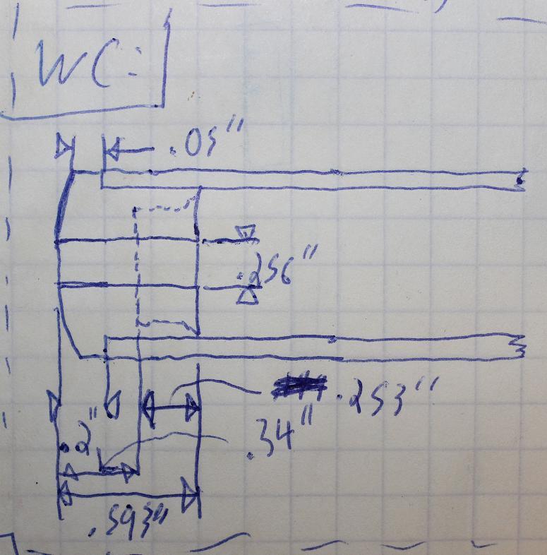

My question is, do you think there's enough thickness in the end cap to drill and tap for a threaded female QD socket, something like Grovetec offers so I don't have to clamp anything on the barrel/mag tube ? I really don't like the idea of clamping something on and screwing up the Cerakote finish.

That's a good idea! The overly thick end caps on the Wilson Combat extensions should be great for this. Plus, when you're not using a sling, the QD socket will still allow the magazine to vent as it was designed to.
Here are my notes on Wilson Combat extension end caps: Now, my Wilson Combat +1 extension has a partially hollowed-out end cap, as shown by the dotted line in the image above. However, this is an older +1 that I purchased used awhile back, so I don't know if they're still being made this way. The Wilson Combat +2 I have was more recently purchased new for a review, and it has a solid end cap.
Either way though, you should have more than enough meat for one of those thread-in QD sockets to hold onto. Even if you have a hollowed-out end cap and the rear of the socket sticks out into the extension, the spring should simply fit over it. Worst case, you'll have to trim your follower's tail a little to maximize your capacity (in the event that you want or need that extra bit of space).
Installation should be pretty straightforward. Drill, tap, and screw the socket in with a little epoxy or red loctite. I'd go with the threadlocker personally, so I could get the socket out in the future if I needed to. If you can, take some pictures of the process; I'm sure Vitaly would love to show this off over on the blog.
Re: Question about Wilson Combat +1
in your drawing, it appears the cap is over 1/2" thick, that should work fine.

It appears to be brazed or soldered. You shouldn't have any issues with it breaking loose during drilling & tapping.
