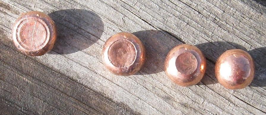

One unexpected thing I got out of that test is that the pellet velocities had dropped to typical muzzle velocities for pellets from "high-velocity" .410 buckshot shells optimized for the short barrels in .410/.45 Colt revolvers. At those speeds, the pellets have minimal wounding potential relative to a handgun JHP. This is contrary to the beliefs of many who advocate the use of those revolvers for personal defense, and claim that they will blast a permanent, fist-sized tunnel through a torso with buckshot.

I'd be interested in seeing your test results. The problem I keep seeing with the "high-performance" .410 buckshot loads is extreme pellet deformation. In order to get everything they can out of those laughable revolver barrels and put somewhat-encouraging numbers on the ads and packaging, these things are loaded with very fast-burning powder, and topped with a heavy 4- or 5-pellet stack of large buckshot. When that powder touches off, the acceleration crushes the linear stack of pellets straight back, and they come out of the barrel as flat disks. This is one of the primary reasons that the effective range of buckshot out of the revolvers is so uselessly short.
410 buck.JPG (89.2 KiB) Viewed 8600 times
At very close range they'd do decent damage (they'd still have the same kinetic energy after all, and would probably do more damage to a target than a round ball), but with that short range and lack of consistency, the only half-way plausible alternative to simply loading the revolver with good .45 Colt JHPs falls on its face. You might see better results from a long, smoothbore .410 barrel, but I'd still expect the same pellet deformation. Slugs may be worth trying; .410 slugs are lighter than most effective handgun bullets (usually less than 100 grains), but at least you'd have pretty respectable velocities out of the longer barrel.
