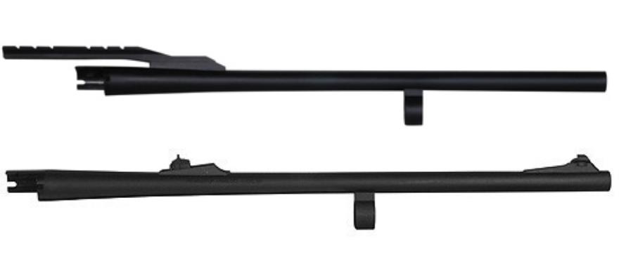

Not all saboted slugs are going to be stabilized by the couple inches of rifling you get in a rifled choke tube. And even if you find some that don't keyhole at 25 yards with just a rifled choke tube, they still might not be stable enough for precision work at longer ranges where they actually offer a substantial benefit. You may actually get better results with smoothbore slugs and an IC or skeet choke. Accuracy aside, there are no safety concerns with shooting spin-stabilized slugs in a smoothbore barrel, whether the choke is rifled or not.
If you want to get the most out of advanced slugs like the Remington AccuTips, you would be best off getting a fully-rifled slug barrel that you can swap on for longer-range deer hunting. You can get these with either a cantilever rail for scopes or open rifle sights, both of which should be compatible with your 870 (mostly depending on what accessories you're running on your receiver), and will maintain their zeroes while off the gun. It will be a bit more weight to pack to camp, but a lot less than another complete gun, and plenty of soft or hard cases will let you fit a second barrel alongside the shotgun.
20ga 870 slug barrels.JPG (16.1 KiB) Viewed 2094 times
