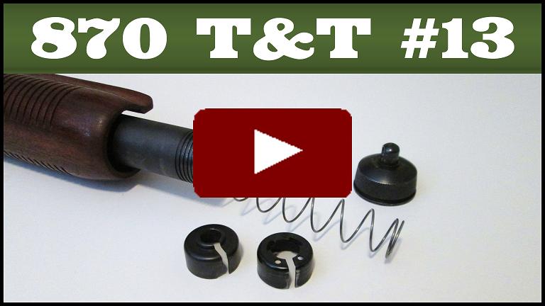

Turns out a Benelli spring retainer (part # 60406) will work fine in a 12ga 870. Better than fine, in fact; not only do the lug holes make removal & replacement a breeze, its larger center hole also allows a magazine plug to fit through without having to take the retainer out of the tube. This is a definite upgrade over the factory press-in spring retainers. Highly recommended.
For more details:
Click for video
Click for video
870TT13 Thumbnail_button_small.JPG (38.25 KiB) Viewed 8839 times
Thanks Sven & Dread for the inspiration & assistance.
