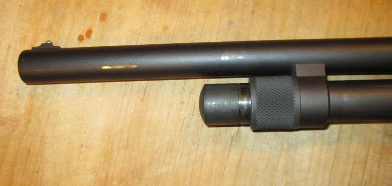

An extension is nice to have on a HD gun. Odds are, you'll never need that many rounds (actually, odds are you'll never need the gun), but better to have the shells and not need them than need them and not have them. A lot of the kind of home invasions you'll want to be armed for are carried out by groups these days, and anyone who thinks they'll be scoring perfect hits in the stress of a life-or-death shooting is deluding themselves. If nothing else, the added mass of the extension and extra shells will reduce recoil.
If you want to go with a full magazine extension, I'd recommend one of the Remington factory extensions in a heartbeat. Nothing better on the market for a short-barreled combat/defensive build in my opinion. If your barrel's longer than 20", you'll have room under there for a full +3 extension.
However, if you want to save some money and avoid complexity, a single-piece +1 extension is a great way to go as well. I really like the look of one of these on an old-school riot gun, and they're so simple and easy. There's no need to mess with clamps, coupling nuts, or proper tube mating, these are essentially a long magazine cap, and they go on and come off exactly the same way.
