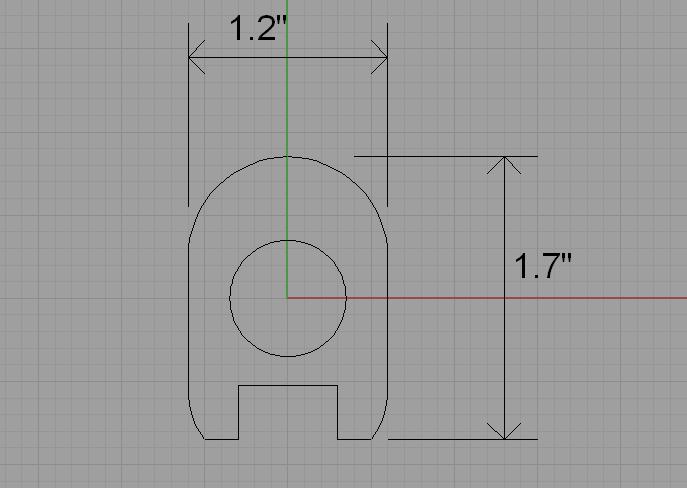

You should be able to figure out which 20ga you have by contacting Remington directly, but for reference, here are the general dimensions of the raised bearing piece that fits into the receiver, measured on my 12ga synthetic stock:
12ga 870 stock bearing dimensions.JPG (31.46 KiB) Viewed 3231 times
If the bearing piece on your current 20ga stock has similar measurements, you should be able to use any 12ga furniture on it as well.
